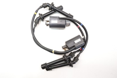

Cutting the spark plug cables does not ensure that the vibrations disappear, I can try again to see if there is a result, check the resistance in the spark plug connectors and finally I only have to buy new coil and cables, I have read on this forum that they can use the one from other models like the R6 to see if that solves the vibration problem

It's complicated, but I ended up replacing the original ignition coils with 4 coils, one over each plug. https://www.600riders.com/threads/vibration-a-cure-for-bad-vibrations-spark-plug-caps.48874/page-10.
I got tired of cleaning up my spark plug caps, so I gave tis a try.

Can you tell me which coils you bought? for me to buy the same ones

You are due for a valve adjustment. If one of the valves is far off from the others you will have uneven combustion which can lead to vibration. After the valves are adjusted you should sync the throttle bodies. COP (coil over plug) is a good mod...I've done it on other bikes. I believe I have used Suzuki (GSXR) and Honda (CBR) parts in the past.
I bought this complete set of coils for €50 https://www.ebay.es/itm/145134430234
when they arrive I will check them with the multimeter, let's see what resistance in ohms it gives me, if the kit is good I will assemble it and test the bike, if it remains the same, I will cut the coils a little. cables, and I do not rule out adjusting the valves, adjusting the throttle body, to see if there is any luck

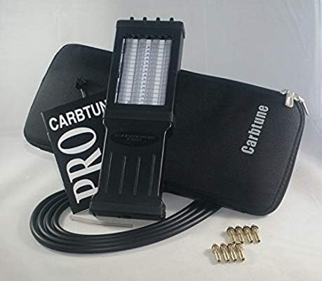

Besides all the above, INVEST in a good synchronizer
I have (and love) the Carbtune:
https://www.amazon.com/CARBTUNE-PRO-4-W-Pouch/dp/B018UTHGPE
The shop will charge you labor about the same as if you bought this
high end tool. It literally pays for itself with one time use...
As for settings at the factory, the engine does need to be sync'ed in ANY EVENT.
The closer you can get them, the smoother the engine.
The factory allows for 10 mm difference between cylinders. After adjusting one valve
I re-synced and you can see got it MUCH closer than 10mm:
