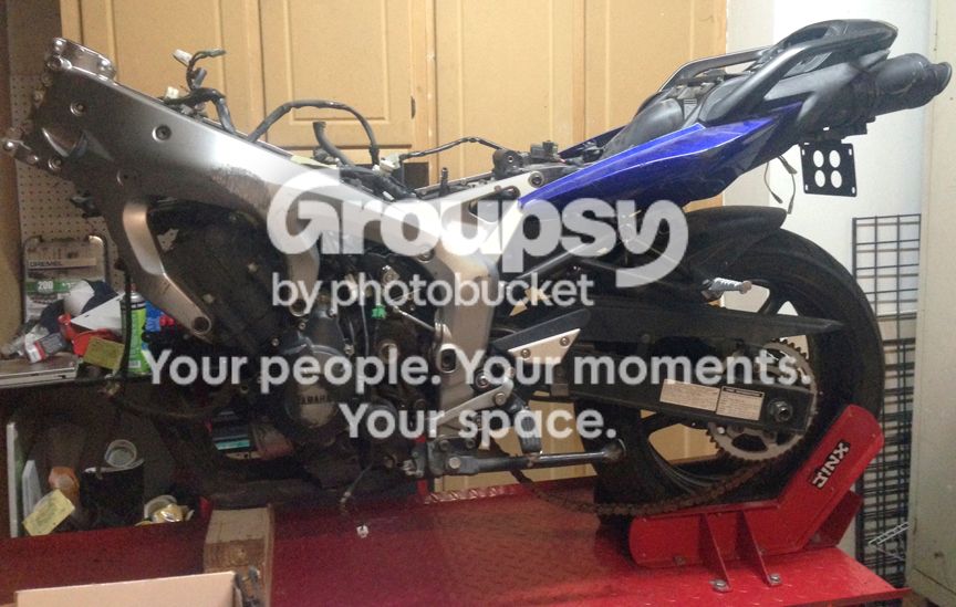

Hello all I was not sure where to put my build thread so I'm guessing the StreetFighter part of the forum is a good place to put it since it will end up being a StreetFighter. I have always wanted an R6 but I did not like the riding position it hurt my back when I rode for 20+ miles. Found out about the FZ6 and was convinced by a friend that owned a motorcycle shop that it was a good project bike not to mention that he had 2 that were just sitting in the corner of his shop. He convinced me to purchase one of the FZ6's from him. Then I started digging around to see how I can make the bike my own & instantly fell in love with the R6 Front conversion and the rear R6 Swing arm. I know the mod has been done before to great success and I do not want to reinvent the wheel. This is will be my build Thread I will call my projcet. Project
Here is what she looks like at her new home..

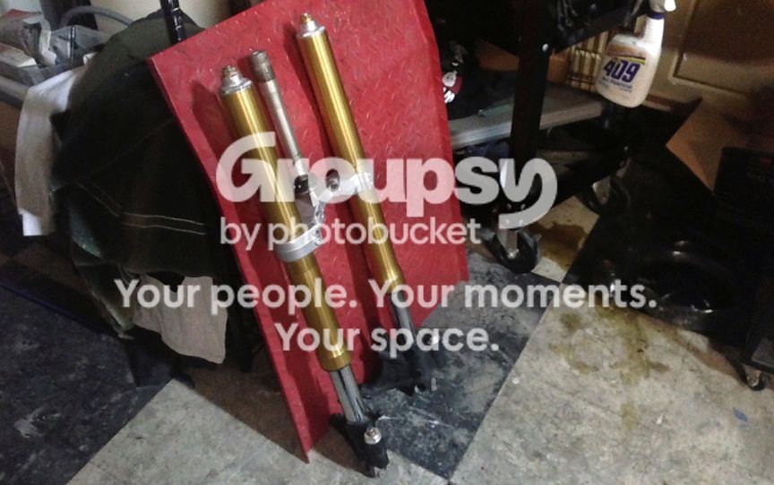

First thing is first! Getting the the front R6 forks so the bike can be a full roller. I have the forks but need the right bearing races to get it on properly thanks to those that has built before me this mod was one of the easier ones to accomplish. Here is a pic of the forks I will be using.

So its been a while since I updated the thread but that does not mean I have not been working on the project. The main thing that I was waiting for was the All Balls racing triple tree bearings. They fit great almost makes the R6 Front end look like it was stock..

Looks like you have yourself nice little project. Please be careful about removing material to clean up the frames rash as its cast and may fracture if you thin it much.

Looks awesome bro! interested to see how everything turns out the r6 fork swap is my next project I want to tackle. what year r6 are those from?
All the R6 parts are from a 2000. I wanted to swap subframes but the effort wasnt worth the reward.

Thanks Bud Ill make a mental note of the year. I noticed the newer gold forks on the r6s aren't the same shade as this theyre more dull/faded looking even when brand new. Keep up the good work and post some more pics!!!
