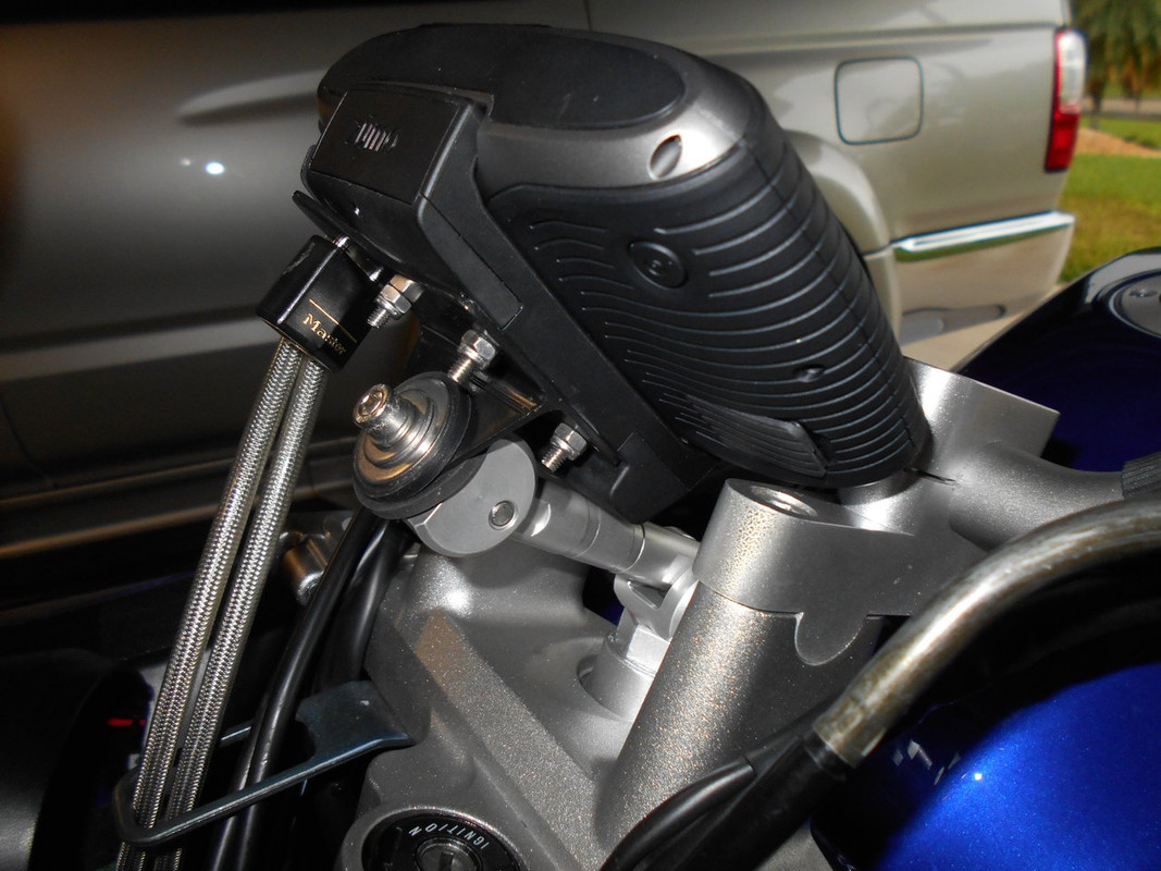

I use the stock bars but with combo riser/set backs.
I can't do the excessive leaning(stock is too much for me).
Handlebar end weights would certainly help, "Grip Puppies" also work for me..
A throttle body sync, especially at 4K, helps smooth the vibes..
Some pic's:
