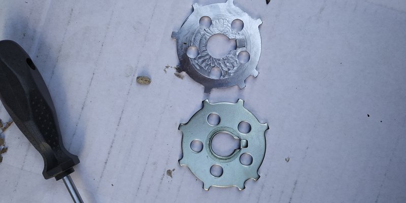

Today the postman rang-
Rotor came, installed and it is gooood!
Went for a ride and the result is pure joy!
The bike is much more linear concerning power delivery! Installation was plug and play. Twisties are much more fun and you know that power is there when you are coming out of the corner and pull the cable! I absolutely recommend this mod! Driving with ROZ 95 without any problems (heat same, no pinging!). What a great little part!
Rode 160 km twisties and mountain roads. Love it. If there are questions: just ask!

I have an idea about producing it.
I can just ask a machine shop to laser cut this part from sheet metal. Then paint it to black. It'll cost around $5-10 locally.
But i need dimensions :=)
They can cut using Autocad drawings.
TKBone
Mar 7, 2018
52
Österreich
Sorry all I can give u is this Foto. Don't forget the square on the backside... And 36€ ain't that much!

Could someone please provide even a rough idea of what is necessary to install this part? I'd like to pursue this, but just showing the part is like showing a left handed booblefletzer.
^^^^ What he said.
As for installation, it's pretty simple. Take the 'oil pump' cover off at the green circle in image below. Be careful with the gasket...or have a new one on hand.
TKBone
Mar 7, 2018
52
Österreich
Inbus for the cover, a wrench for the rotor screw, gasket sealant, a razor blade for the old sealant remains and i used loctide on the rotor screw. That's what i used :) Just came home from riding and still there is a grin on my face!
