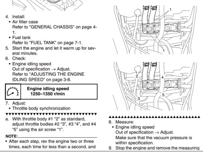

Did you check the "base" screw on the block used to sync the TB's?
It should be about 3/4 -7/8" a turn out... A throttle body sync wouldn't hurt either
Pic will expire in 48 hours
Cocoloco
Dec 12, 2021
187
43
Manila philippines
I cleaned the sync block and the throttle bodies before, and yes i set the base 3/4 out and sync the TB's using vacuum gauges. Revving it steady at 3k rpm it all seemed to have the same vacuums.
