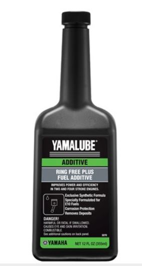

Question, did the bike sit for any length of time (over a month) with ethanol fuel UN-STABLIZED?
That could cause running issues and stalling. Adding good fuel to old fuel, you now have more bad fuel.
If so, dump the fuel and start fresh. Inspect the fuel pump filter as well if yanking the pump)
I would strongly recommend trying Yamaha's RING FREE. It's a fuel system and top end CLEANER (not a stabilizer) and IME, works extremely well.
*I'm guessing that the fuel system is making the engine stall, then your popping a code.

Yes sir it did sit in my garage for about a month while we had a very rainy month. It did not have stabilize in it and it most certainly has ethanol in the fuel.
I've never changed the fuel filter yet so it can't hurt. I'll definitely take your advice and siphon the fuel, replace the filter, give the Yamaha Ring Free a try, and fill her up with fresh fuel. I think it was just a dead battery as I've ridden about 30 miles since I've charged her up and haven't had any issues. This still sounds like some good preventative maintenance and for a few bucks can only make things better.
If the problem comes back, I'll revisit this. As for now, everything looks golden though.

Good info.
Also, that pump filter is NOT replaceable (and the pump has to come out if accessing the filter). If clogged with crap, brake cleaner, an air compressor should help. (Probably NOT necessary un-less you've seen rust in the tank).
I would however (if able), remove the tank, flip upside down and dump it in a catch basin (looking for any crap / water in the tank). Then blow dry (hopefully blowing out again, any debris.
I run RF in EVERY machine I own.
You can run a SHOCK AMOUNT which is 2 oz / 1 gallon (won't hurt anything). Regular usage is 1 oz / 10 gallons.
I can say you'll feel a difference once it's run thru the system..
