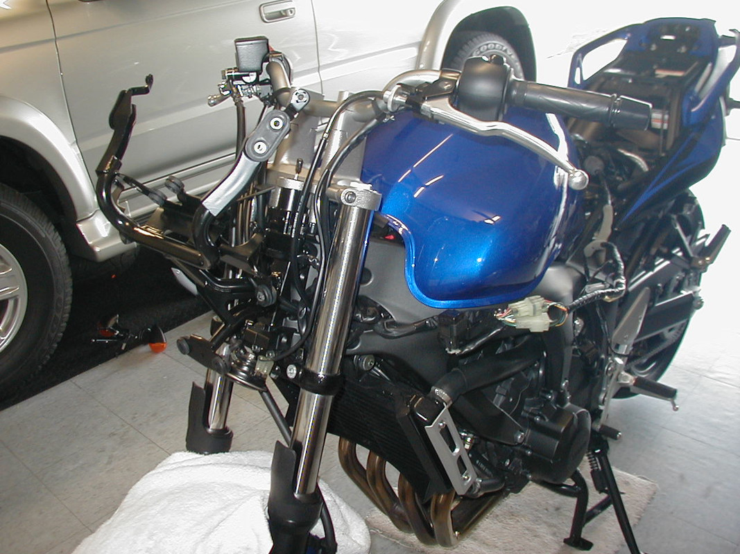

What specific brackets are broken?
Replacing the entire cowl would be the correct way to go but isn't cheap. I've had the stock left directional tab on the cowl break off but epoxied it back on-no issues and not visible..
R&Ring the fairing is somewhat involved, not super difficult, but..
My '07 stripped down (when I initially got it-wrecked), replacing the fairing stay, fairing, etc:
