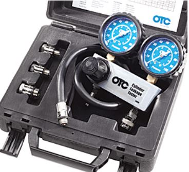

I have this leak down tester (but use it fairly often on smaller engines I work on):
Many auto parts stores lend tools, dunno if they'd have a leak down tester for "borrow".
As stated earlier, a compression tester would work, if one cylinder is considerably lower (or all low),
you'd have to dig deeper.
A small pancake compressor is about $100. Just need to get to about 100PSI (tops) for the LD tester. Any compressor (if you have the room), is a MUST for airing tires, etc so might be a good investment.

I usually do my leak-down tests at 80psi. It's a lot easier to hold an engine at 80psi and the extra 20 psi doesn't provide any additional information. If a cylinder can hold 76/80 I'm happy. If it's 72/80 it has my attention for something to watch. If it's below 72/80 I'll be listening for air escaping from the exhaust, intake or breather.
