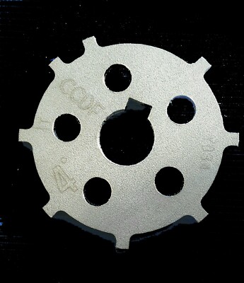

Anyone have any idea where I might be able to order an ignition advance rotor for my 2008 FZ6 to ship to or within the US?
This one is from the UK. He doesn't ship to US

Yeah, PM me if you do, I'd be very interested!
I'm planning on starting to upgrade some things... Mostly performance wise. Have you noticed quite a difference with the 4 degree ignition advance?

I believe so, been riding with it this way for awhile so can’t really be sure what’s real and what’s in my head.
Throttle snatch was reduced, and it pulls more linearly, especially in 3rd and 4th gears. I’ll have to reinstall the OEM and go for a spin to really see the difference though!

I've seen mods where people file down one side of the ignition rotor to "advance" timing and plan on doing the same ver soon. You don't need much to do it, a caliper that reads to thousands of an inch, fab up a tool to hold rotor in place when removing and reinstalling and gasket makes or new gasket. I seen a video on YouTube about a guy doing it and explaining how it works and all that then found it in forms. When I get home ill see if I can find it again and post a link. I'm in USA as well can couldn't find a seller. But everyone says the gains a amazing for such a cheap mod. Only this is you'll have to run premium fuel and a fuel controller is also recommended. In hotter climates colder plugs as well to avoid knock
