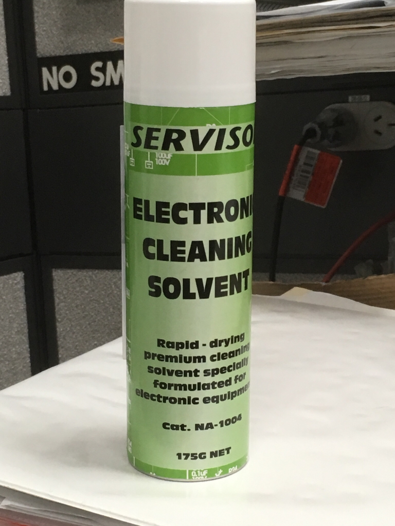

I'm going to squirt some of this in once i cover all the painted surfaces and then try the silicone lube- my bike is garaged at night and pretty sheltered during the day, but i am an all weather rider so if its wet out and i need to be somewhere else the bike is my only option
I'll have a good look at all my lubes see what might be suitable
One question tho Randy, does the actual key stay greasy? What brand do you use?

Adrian, yes it will have a tiny film for a while. You'll get 97% of it off during your initial insert, pull, wipe, insert, repeat cycle. Figure 10min of in out wipe. :thumbup:
