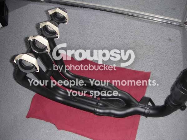

Do our bikes really have 3 cats? Where are the other 2? :confused:
I think the change was in 2007.
Pic of 07 and newer header, the two bulges are cats
06 and older header
I have thought about trying to adapt an older header to my 07, just as a cheap way to have a full system without cats. I'm not sure what performance increase there would be but surely it would help some. I've seen a few on ebay relatively cheap, I just wish I had the time and $$ to do a little dyno time to see how much this stuff really helps the bikes power.
