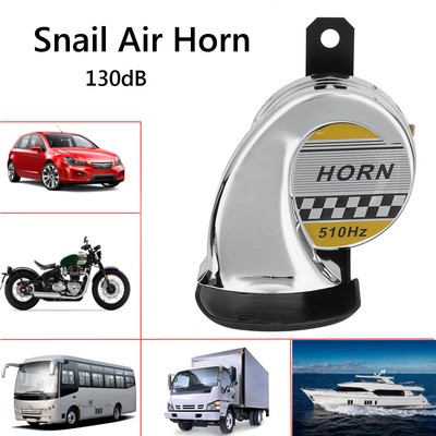

My stock horn on my 2004 FZ6 sounded like a moped! I decided to invest $10.38 in a compact air horn and what a difference!
Happy to have a much louder horn, it only took 5 minutes :)
What horns have other people swapped in?
