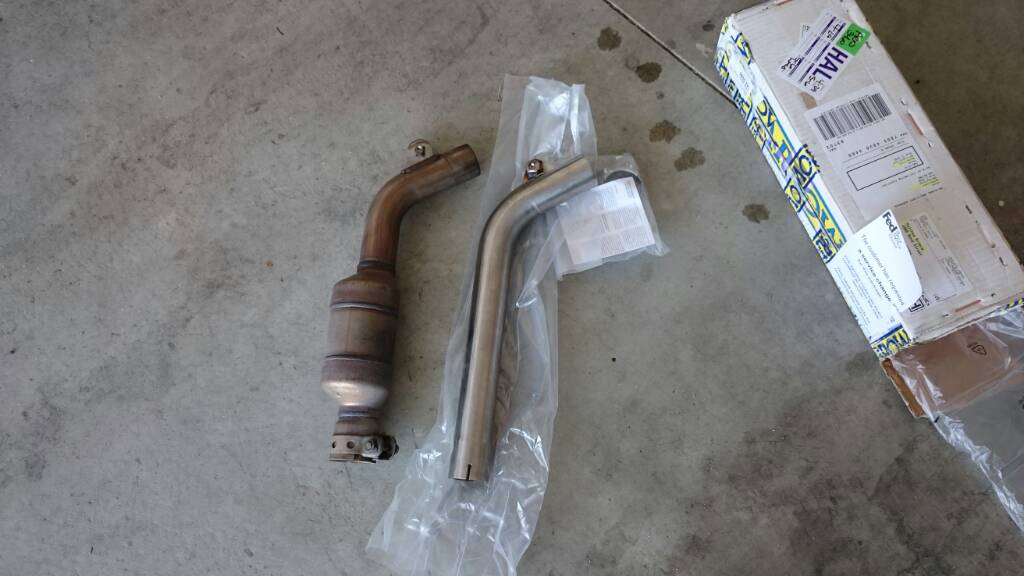

Installed my mid pipe today, didn't take too long. Old pipe weighs about eight pounds, new one is maybe a pound.

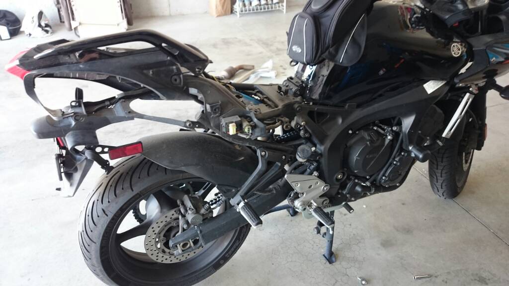

Disassembled to get the old mid pipe out
Old vs new

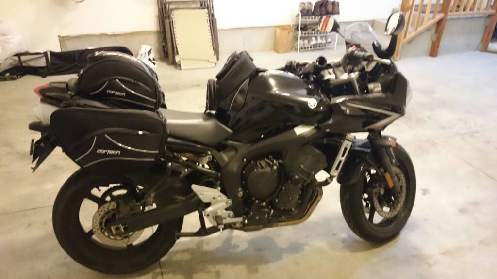

Back in one piece :)
