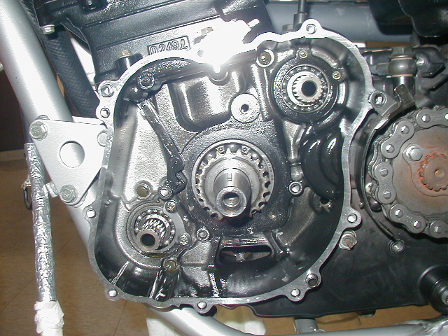

Side note, my first, 1989 Kawasaki KLR 250, I got 73,000 miles (street) out of the piston/rings(rings were at the end of spec's), original cam chain (3 times longer than the FZ). That engine in particular, liked to have the main left side (rotor) roller CRANK bearing cage fail every 32,000 miles. Part of the cage actually disintegrated (god awe-full noise too!!). At 64,000 miles, it started knocking again. Complete tear down again and replace that bearing.
My 2005 KLR 250, when swapping out the cam chain at 28,000 miles, I checked that same bearing. Sure enough, maybe .005" play. That bearing will need replacing soon...
Sold that and bought the FZ as a replacement..
The main bearing is under that double sprocket gear (cam chain and balancer sprocket):
