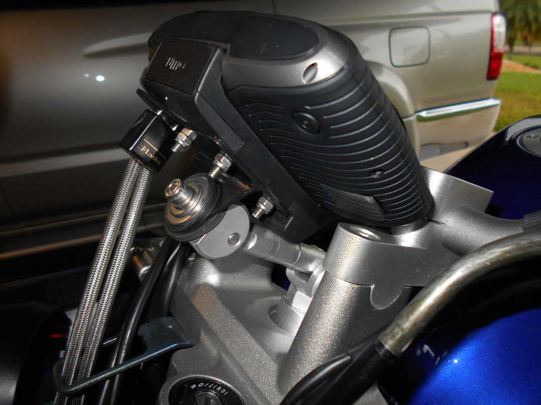

I have that rise and further set backs..
With the original lines (now SS), I slightly re-clocked at the master banjo bolt and removed the keeper at the lower triple clamp to get more line out of the brake line..
The clutch, throttle and wiring are not an issue at all..
When I upgraded to SS, I did get it a tad longer but this the riser / set back and all the stock line reach:
