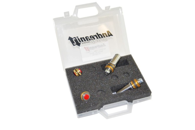

Hey guys, I ordered my springs and the new oil and was wondering what you all thought about ordering something like this. They are new compression and rebound adjusters for the forks. I figure since some of them aren't clicking and I'm already going to have them apart maybe I should add these. From what the page says its for the OEM forks.
