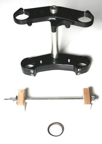

Preparing for the R6R fork swap.
I made a tool to put on the new races. But not sure if it will work.
What do you think?
