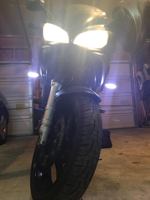

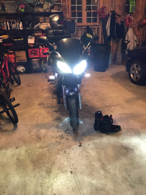

I recently upgraded my turn signals to the Yamaha LED Blinker Plus lights (Thanks [MENTION=15974]FinalImpact[/MENTION] !). I love the look, but wasn't thrilled with how different the blu-ish white LED's were compared to my yellow-ish halogen headlamps.

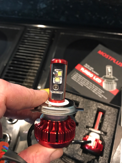

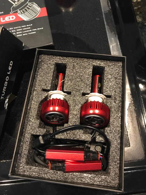

So I did a bit of research and bought a pair of LED H4's and a pair of H7's (cheaper by the pair, and I'll have spares!) on Flea-bay. Install was pretty simple. I secured the drivers to the inner fairing with double sided tape. Hardest part was trimming the dust seals just enough to fit.
These lights are super bright. Advertised as 3000 lumens for the H7 and 4000 for the H4.

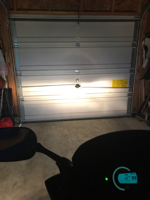

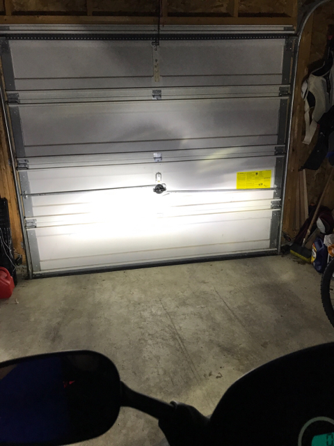

Some of the light leaks in an odd pattern as you can see in the pic below (this is the biggest complaint I could find in online reviews.) But I'd say 95% goes where it's supposed to and other drivers don't seem to be annoyed by them. They really light up the road, especially with the brights on.
First pic below is halogen, followed by the LED's:
Not sure why I bought units with red fans... But whatever. I like 'em!

I switched over to LED headlamps a few years ago. The fans are really needed to help get the heat away from the heated LED junction for longer life. I had a supply fail and I had a light assembly fail in the 2 years.
I have the same complaint about incidental light pattern. There is a lot of light on the ground right in front of the bike. This is not good because you can claim the forward light is 2 times the halogen but if you light the ground right in front of the bike, your pupils dilate and they receive much less light from reflected objects in the distance. That means the extra lumens are really not benefiting us. As nice as my LEDs headlights are, I think they need refinement before they can be claimed as a benefit. They are no worse than my halogens but I truly can't claim they are better until I spend more time aiming them which seems to be difficult as I hardly ever ride at night.
Mine are on the SV1000s with 2x H4 headlamps and the FZ6 may benefit much more with it headlamp configuration and reflectors. :)

Thanks Cliff. I read your thread about the headlights prior to taking the plunge. Good review!
I don't ride much at night either... Only dark experience so far has been very early mornings prior to sunrise. Unlike your experience I really don't notice them lighting the ground in front too much.
As I mentioned I mostly put them in to match the blueish white from the running lights. (Kind of like painting the trim in a room, then having to paint the walls because they look faded next to the trim! )
I feel like the extra lumens help with visibility by cagers as well.

Completely agree re: aiming the LED headlights. I feel like I'm finally in a decent place with it (after several tweaking sessions). I don't doubt that I get more light, not only close-by/around me, but also for seeing further - but I know I'm also better seen by vehicles in the opposite direction.
