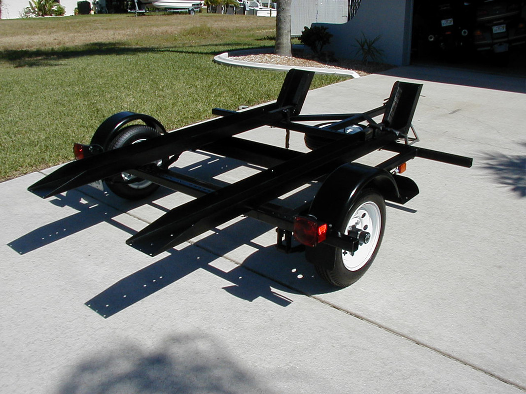

12,534
1,181

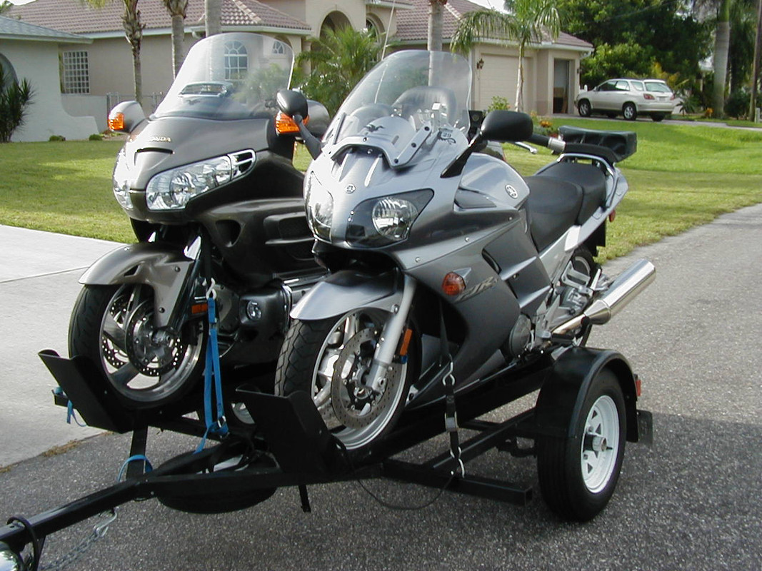

I prefer doing the trailer as I can easily get two bikes on it (shown is an FJR and Goldwing).
The suspension is from Northern, the rest is homemade/designed with 3/16" box steel (extremely strong).
For the loading ramp is a channel bent and then the center DRILLED so the tires won't slip going up or down.
The rack stores under the frame, slides in over rollers, then LOCKS into place.
The actual racks, besdies being bent and welded at the end(one piece), also have a heavy chain welded on the
rack so the front wheel can be locked to the trailer easily.
The front cross member has 5/8" holes every two inches for tie downs.
And as noted above, the loading ramp has two 1/2" hooks (welded to each end that slip into the rack-it's not going anywhere)
One ramp can be removed and the other centered if only pulling one bike as well....

Now on my own home built trailer (certainly not as high as a PU bed), I would stand along the left side the bike, gently slip the clutch while using the front brake. I could easily motor it up but would NEVER try riding it up. You do have to be proficient with the clutch / ft brake.. Too much to go wrong.
Current trailer (with updates)
FJR and Goldwing (on previous trailer I made) :
