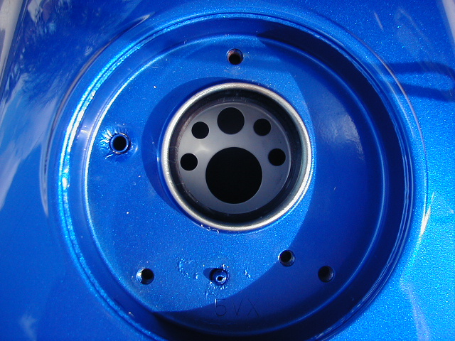

Before pulling the tank, remove the tank cap. Three of the six allan head bolts hold it on. With it off, gently blow (with compressed air) thru the vent / hoses to make sure all is clear.
What you'll see after pulling the cap:
While the cap is off and with some extra hands(to block openings), lift the tank and pressurize it (as if hot in the sun and fuel is expanding).
You should now be able to see any fuel leaking from the fuel pump seal (if need be, spray some soapy water-like looking for a hole in bicycle tube) for air escaping.
