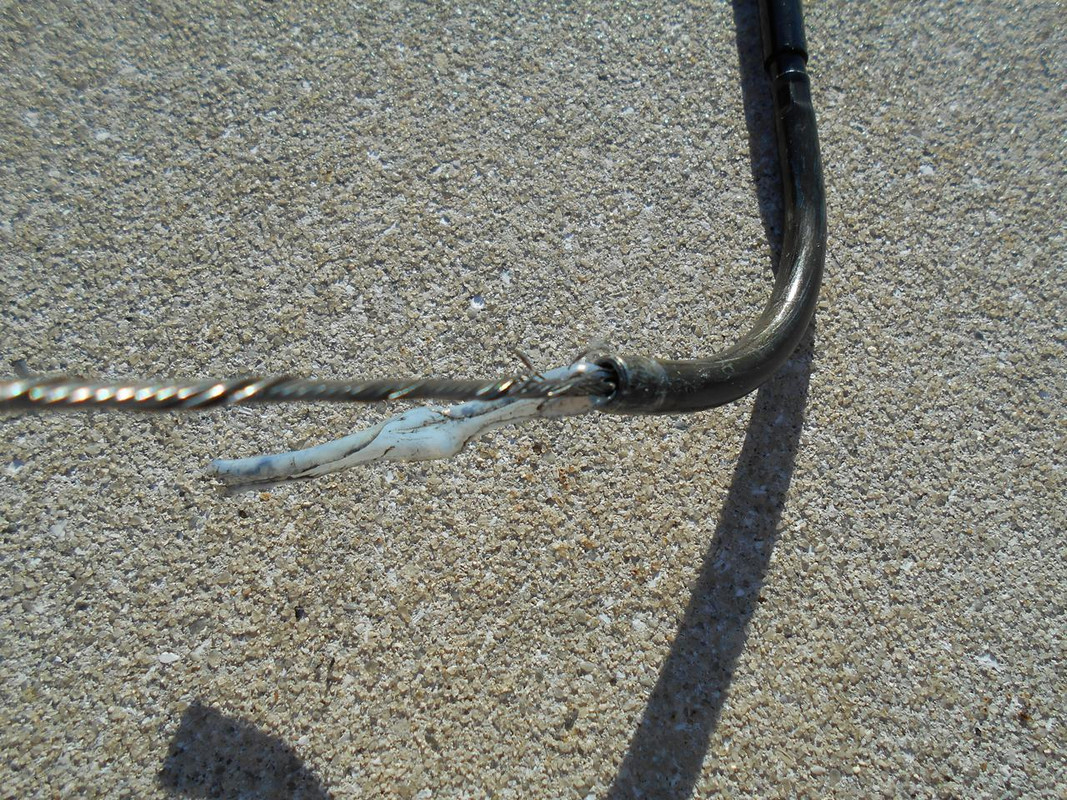

My internal cable for my clutch, frayed, ready to break, with no binding/issues. All inside the cable.
Once removed, I cut the cable open for inspection.
