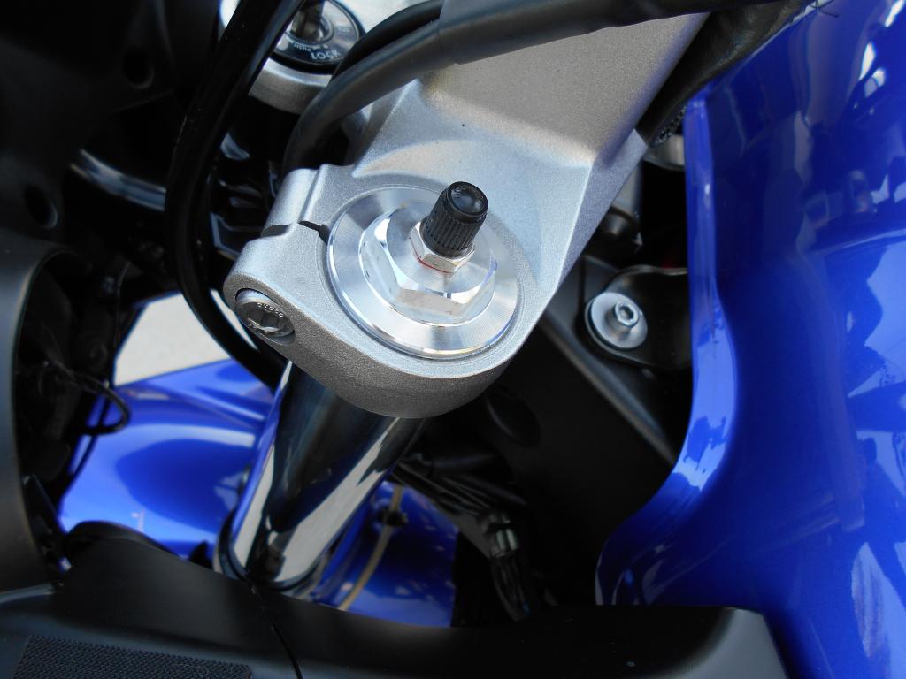

Actually, a much cheaper, works extremely well, looses the "sagging spring issue" is AIR.
In the older days (and still in some newer bikes), air was used for suspension. As it compresses, it's like a progressive spring.
I installed Schrader air valves to my stock fork caps about 3 years ago and couldn't be happier..
About 17 PSI in each leg is good for me. Not too stiff, eliminates the excessive sag, ride is MUCH better..
Air also keeps the fork seals tight (no oil seepage what so ever). I might loose 3 PSI in a year and have to top them off.
Plus I can adjust them tighter or looser easily. No fork tear downs, no valves, etc.. Nice and simple and very effective:
