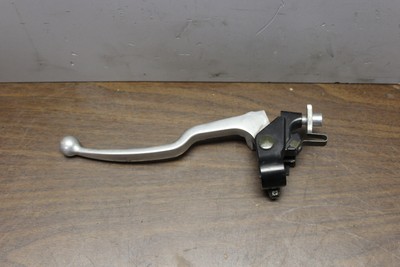

I think you've taken the only viable route with this. Of course, you could always purchase a clutch perch that is compatible with a US spec clutch cable. That is a fast route, but it's gonna be expensive. You will also have a dang-nice perch.
You can also buy a used FZ6 clutch perch...

Oof. Is the difference in the cables just the perch?

The stock US FZ6 clutch cable has a 90 degree bend at the perch, so you will likely need a new cable AND the new perch. But unless the 'customization' has significant benefits, now is the perfect time to undo and avoid future parts issues. Lots of people make their bikes 'different', far fewer make them better.
