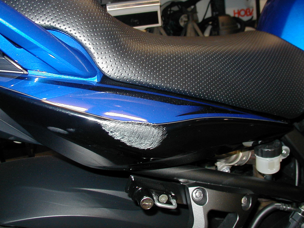

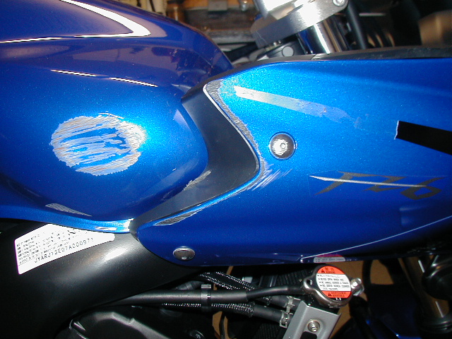

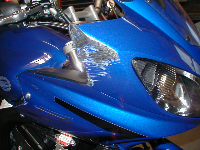

Them gory details are from the previous owner (my friends, KIDS, first bike, bought it brand new on 2007). A 17 year olds first bike, :( I bought the bike in 2009, 4,500 miles, with THAT damage.
He beat the piss out out of it, lubed the chain ONCE in 4,500 miles. Don't think it was ever washed till I got it in 2009.. The other side (left) was just fixed after trying to wheelie but was NOT successful in his landing....
I like the naked look but prefer the fairing, at least until I drop it at 0 MPH and bend up the fairing stay (and don't ask about that)..
