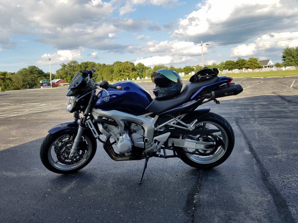

Bracket mounted to gauge - now waiting for the clamps to come in
Also - headlight, housing and brackets came in today. Should have the conversion mostly done this weekend. Then I will just have to hide some of the wiring, the horn, and the turn signal relay. Any advice?

You can also mount the mirrors like this, just need some longer bolts.

Advice for hiding the massive wiring harness. It can be tucked as is, but it's pretty darn tight. You'll want to verify you can turn the bars lock to lock without interference. I ended up cutting a bunch of wire out and resoldering/heat shrinking the harness as a much shorter harness. That's what I would recommend.

Will you let me know if you can use them with the bar ends? I'm needing mirrors too. It's rather eerie riding and not knowing what's behind you.
Sent from my SM-G930V using Tapatalk
Mirrors worked perfect with the bar ends. I bought these spacers from Lowes which fit perfectly, just needed to be cut to length.
When you cut them, make sure you make the throttle side a bit longer so that the mirrors don't catch the throttle. I will give you exact lengths if you end up buying the same mirrors I am using. These mirrors are great by the way, surprisingly you can see way more than you could with the stock mirrors. Some people complained that the screws backed out and the mirrors got loose, I dabbed a bit of locktite on the screws, it wont be a problem.
