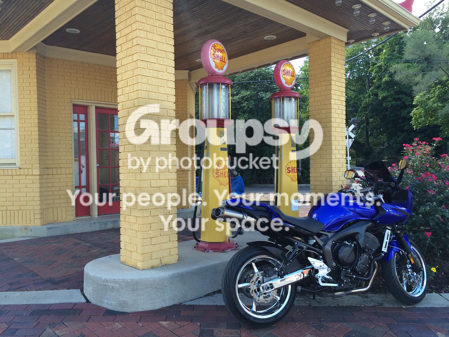

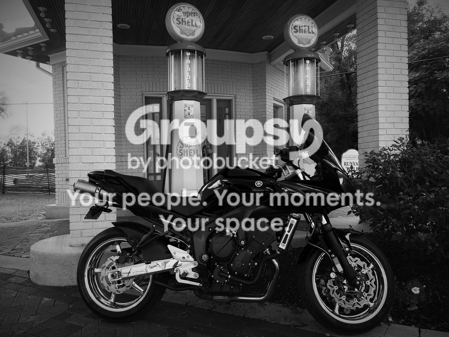

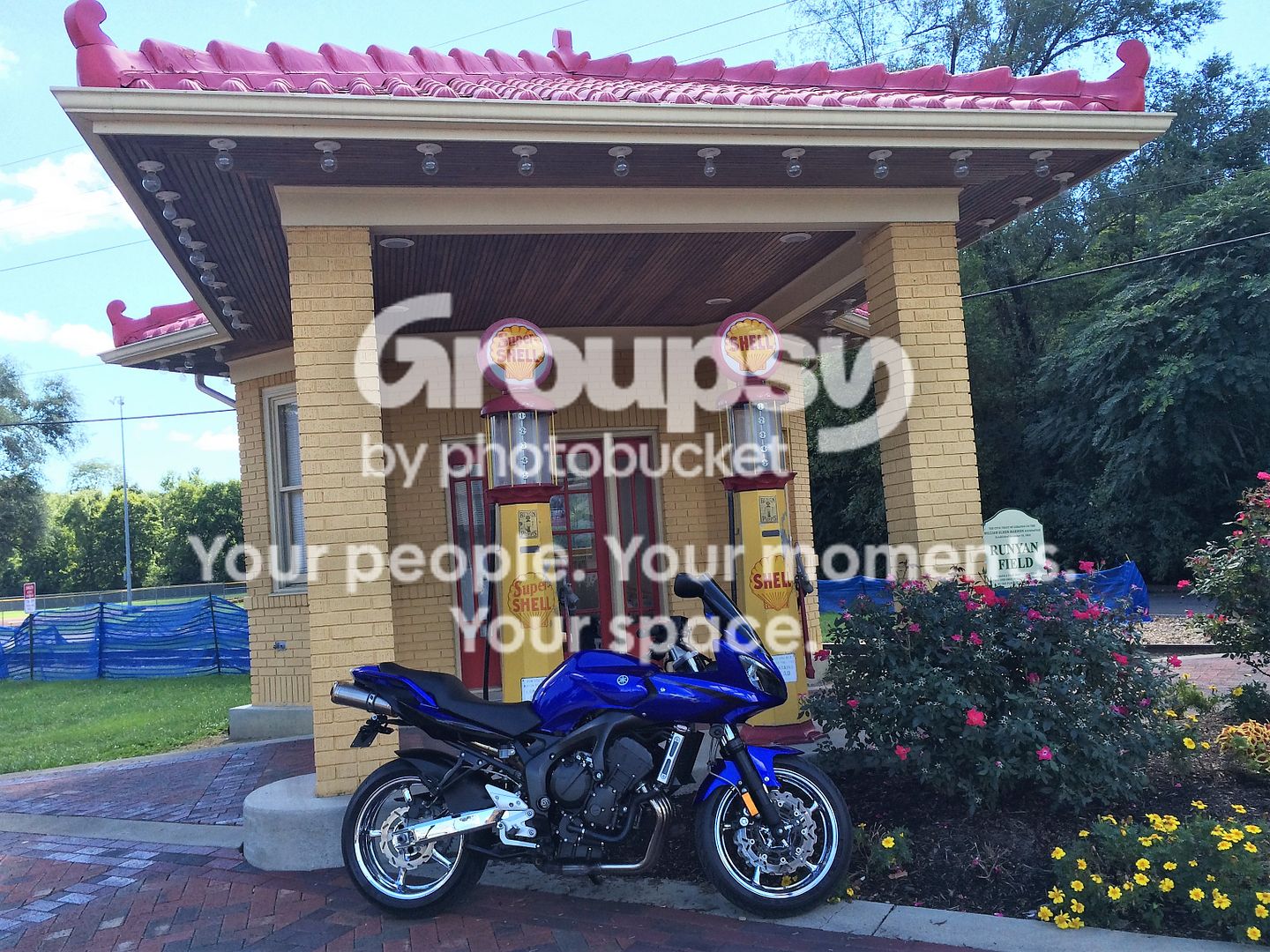

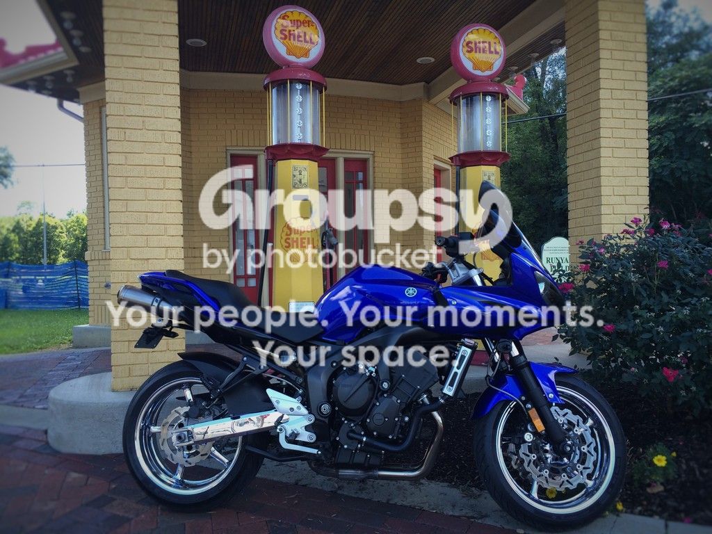

Enough babbling, here are a few pics I snapped today while taking a couple hours of ride time.

Nice looking bike. I'm curious, how many miles and how much did you pay for it? Looking to sell/trade mine and wondering what people are paying for them.

Best year and fastest color too!! Love the polished wheels.
Now you have to polish up the header to match!
Some "Mothers" and elbow grease:
IMO, that rear brake line has to go!, (or shortened). Jeez!!
The original Hel rear line was approx 1.5" too long and looked goofy. I had them shorten it
up so it fit correctly:

I've been working on the header a little at a time, still have some work to do though. Tried Mothers but it wasn't making much of a dent in the staining/tarnish. I may end up sanding and fully repolishing. If that doesn't work, I'll pull it off and put it on the polishing wheel.
Never really thought about the rear brake line, I'll have a look to see what my options are for rerouting first.

Some folks have done ceramic coating with very nice results....
Re the brake line.
I had dual SS HEL lines up to the master cylinder. I went back to the over the fender stock configuration recently.
As HELs line was about 2" LONGER than the stock line, I had them make it a custom lenth (no extra charge).
If going this route,measure EYE to EYE for your lenth. The cost with all new bolts, washers was under $50. delivered...

Hi Silvertwin, love your bike. Your wheels and discs are awesome. Are the wheels chromed or polished? Also what brand are your discs? I have 67K on the clock with original discs and replaced the front pads only with the rear still original. I also have Hel braided brake lines and Rim Halo reflective tape on the black rims. I've also got a belly pan, a Radguard radiator protector , led gear indicator and Oxford heated grips. Leo Vince slip ons and an AirFlow mesh seat cover for comfort coolness and water runoff when wet. When I need new discs I would love ones like yours. Thought about polishing the rims but haven't pursued it yet. Thanks in advance for your reply. Cheers.
