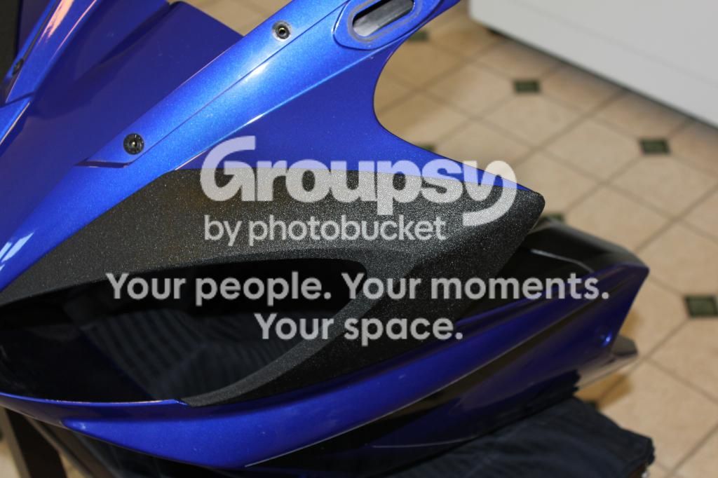

So, here is what I did: Rather than replacing, of having to be skilled in the art of bodywork; I took a lesson from the 2008 Blue Model FZ. This bike uses a matte-black textured finish on the mole which, to me, offers a nice contrast: Photo Below:

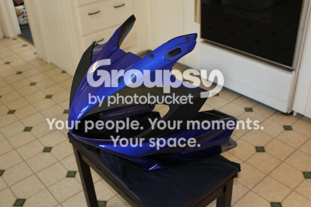

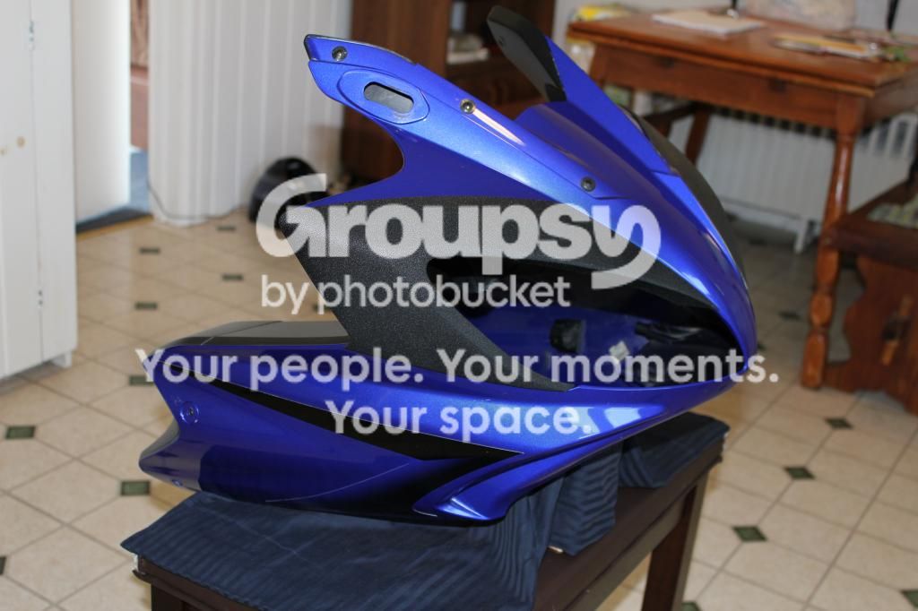

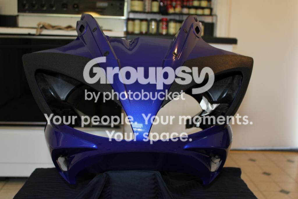

Before:
After:
