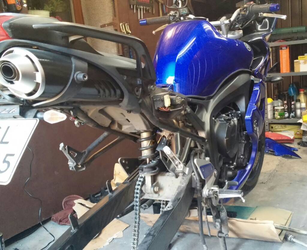

Dropped the swingarm, lubed everything around while having access and finally changed to new xring chain. Took me about 2hours. I wonder how long it will last this time :)
