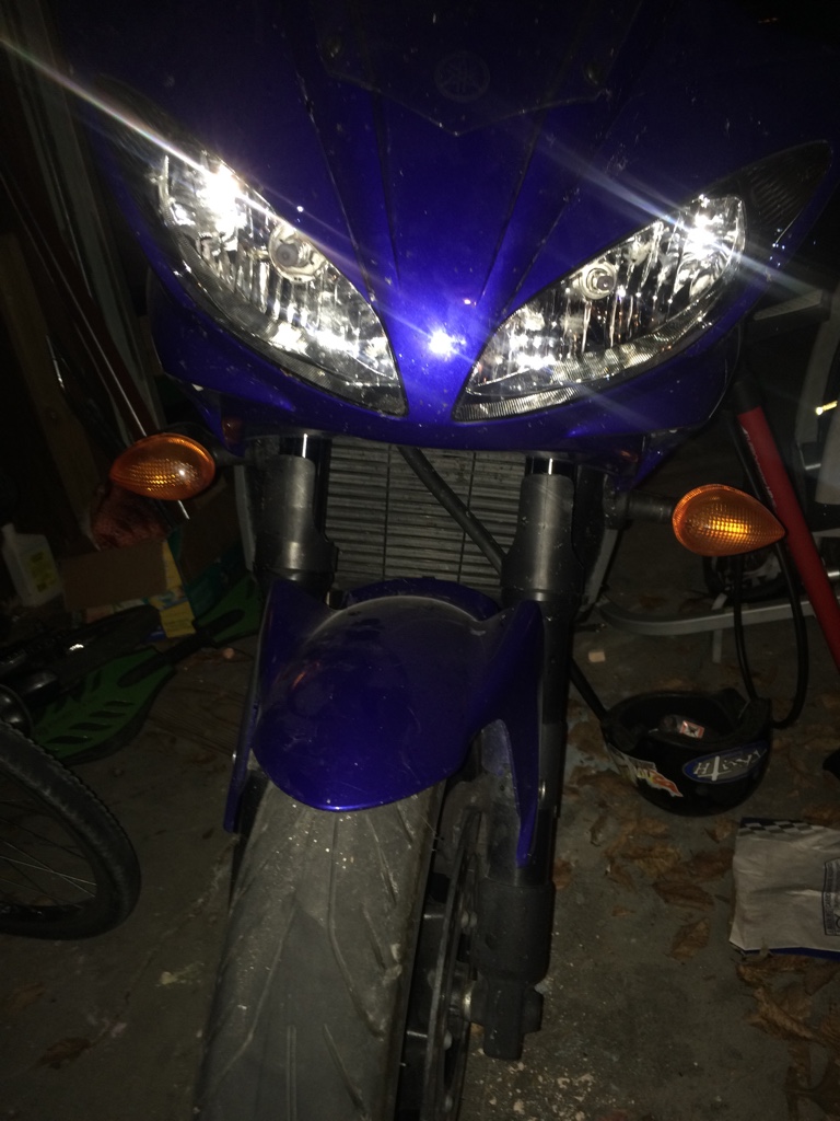

I will take more pics tomorrow, but this is how my front wheel points when the bars are pointed straight.

Glad your ok. I don't think they would total it, even if the forks were bent. Loosen all he the triple clamps, and see if everything lines up. Also, make sure that your handlebar isn't just bent itself. Depending on your deductible, it might not even be worth going through insurance. You can get a set of new adjustable levers for $50, used fairings on here sell for a couple hundred bucks (if you can't rapair the crack), and if the case is still functional, I'd leave that alone.

Plus one on loosening the forks (front end with no load on it-CC with sizzor jack under the header, tire just touching).
Crack loose the triples, axle, axle clamp and do the" old bicycle ft wheel alignment trick". I'd bet it straightens out.
With the cracked fairing, pay attention to main stay. It doesn't take much to bend that. Simply sit on the bike, on the CC and look forward. its pretty easy to see 1/2" difference when looking forward if the fairing is straight or not.
Depending on your deductible, it may very well be cheaper to fix it yourself and NOT have "re-built title" should they total it (not likely from what you describe).
