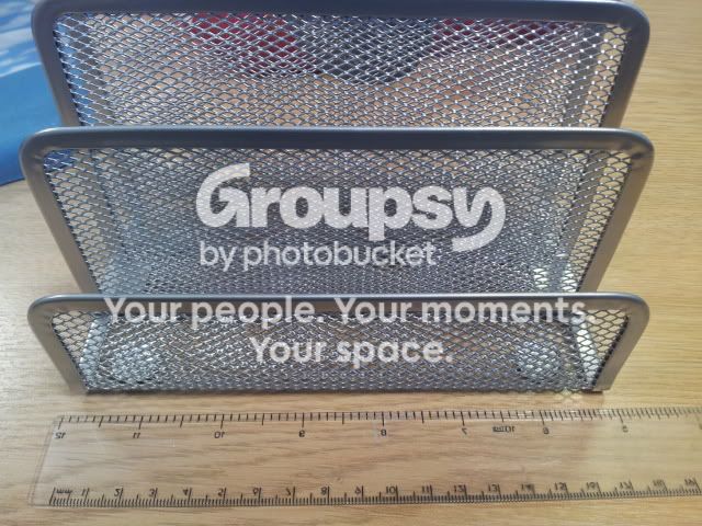

Todays purchase!!! went to the s**t shop at lunch and got this letter holder (£2.50, prob $1.75? i think).... looks to me like it'll make a good radiator guard, bit of hack sawing and black paint required ;) AND I get four attempts to mess it up :D

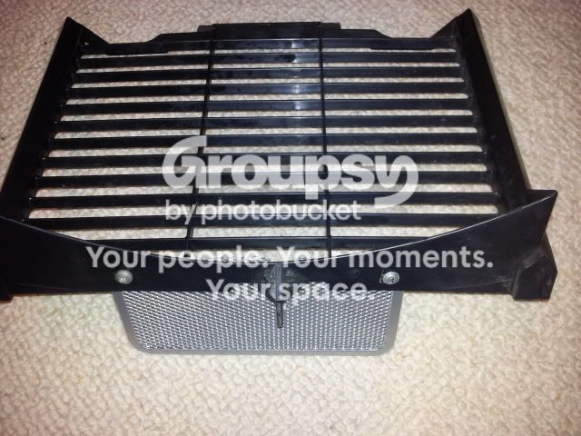

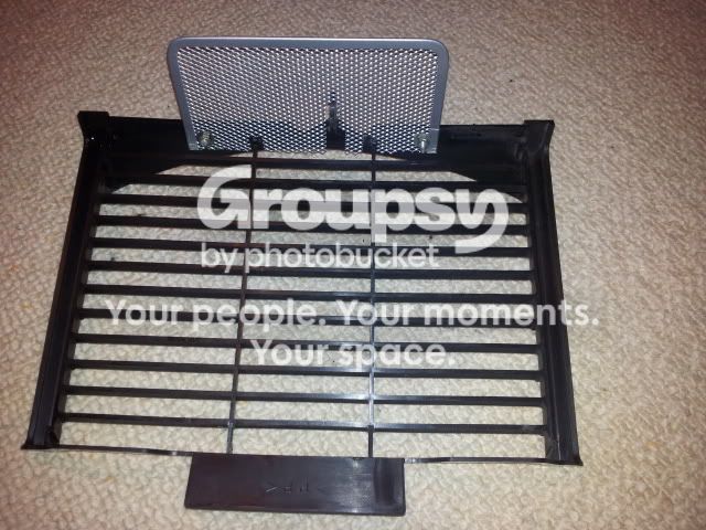

Second job was to attempt the Fan guard using the letter holder above...here's my pre sprayed effort - should the trick nicely!

I've just test fitted it this morning - it is too long (hits the manifold) and I obviously missed the bracket cut out from the centre piece :D
cheers Scott ;)
I'm thinking about leaving it as it is colour wise, its completely out of sight and it'll only chip within days. :)
