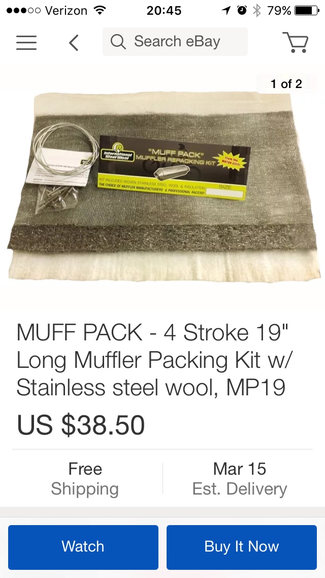

FI found this kit for me on Ebay when I repacked my LV carbon exhaust. I ordered 2 kits and had plenty left over. The sound was a lot meaner than the fiberglass packing, but I really like it now. Research what size and diameter rivets are required, LV suggested stainless steel, as aluminum would fatigue.
Re: FZ6 S2 2008 TRUE Y PIPE TO STRAIGHT PIPE CHERRBOMB/GLASSPACKS EXHAUST (stock...
That kit looks really good. I think that ss mesh would be greta to help the packing, unfortunately my s/s is more like steel wool , I might try an inere layer of the wool near the center of the can and the glass arond the outer layers. I got ally rivets but I know that they will need to be watched and replaced as needed, and I might need to re do the packing if it doesnt give me the desired result. I saw a yiut tube clip that watalking about wrapping the glass with masking tape to help getting it all back into can, so I'm thinking that tight packing is the go even tho' a loose pack would prob absorb more noise( and shorten the life of the packing) ah decisions decisions.
Think I'll suck it n see.
Yeah, it comes with two types of steel wool. I used the glass outer layer that was stock with the cans and used masking tape. I love the exhaust, but I'm getting scorpions next time around just for their never having to repack warranty.

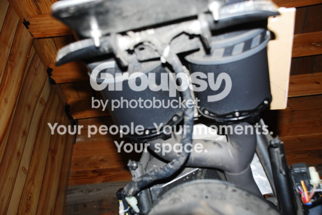

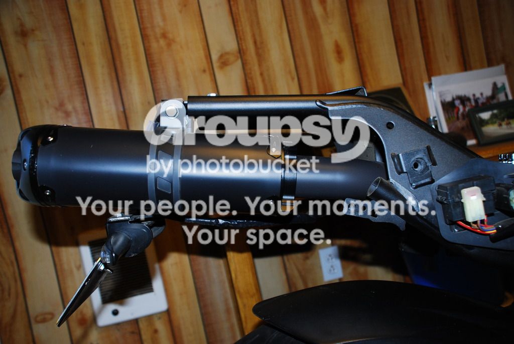

Per PM requests.... Pictures....
I'm not sure want you want to see as its all just pipes...
My first test was Stock S2 header and DeCAT to 2Bro Cans where I welded in a section and ran that for a couple years.
Then I swapped to an S1 header and made another mid pipe but shorter from an S2 CAT. Still into 2Bro cans. I prefer the OEM style coupler and mounts. Its just better stuff than the aftermarket world.

Here's the mufflers I used, when I packed them (Cut open with an angle grinder, stuffed them full of packing material, then welded them back up) Flo-Pro 3300 Muffler Turbo Pack
I've been able to get a good sound out of them, they're a bit loud, but with a bit more baffling, I think you'll be happy. Certainly quieter than glasspacks.
Images of the test fit, not welded or packed at this point, it sits up a little bit straighter the way I have it installed.
