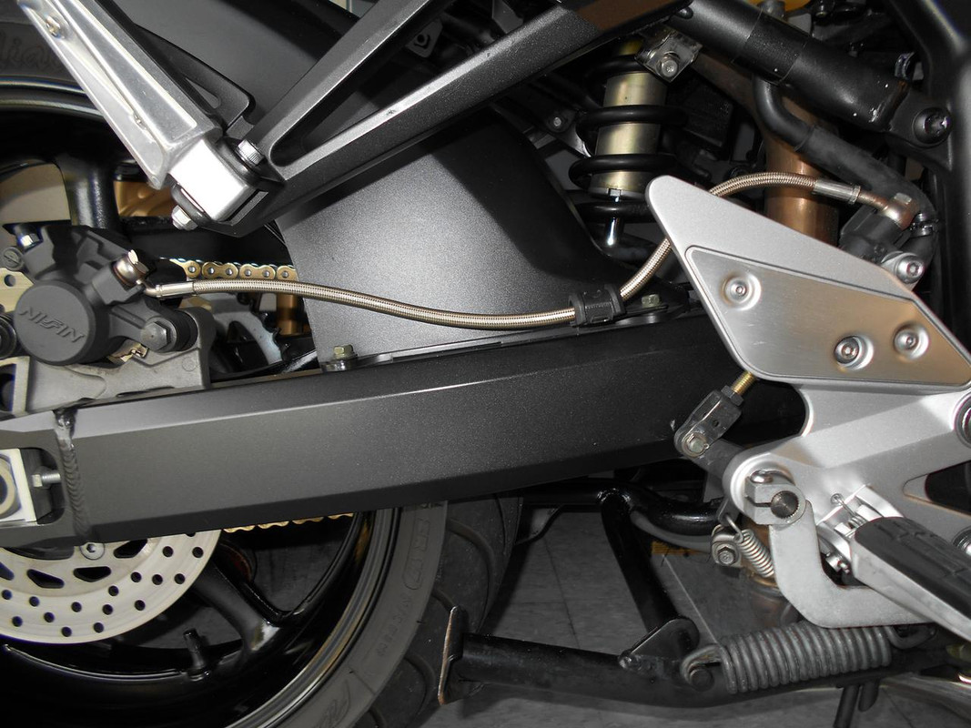

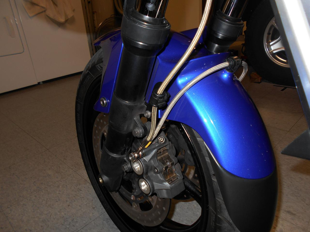

Since you will have the brake system apart, now is a good time to install Teflon brake lines. It’s an inexpensive upgrade that makes a significant improvement to brake feel and function.
Blue in color?
How do they improve it;better than SS braided ?

Re brake lines, I have/like the HEL lines.
