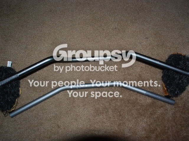

From the top -
FZ6 vs Renthal 755
I wished I'd thought of clamping them up right to begin with.

Desktop comparison. . . FZ1 PN 2D1-26111-01-00
And for whomever i stool the photo from, thanks! Others feel free to add to this. . .:thumbup:
FZ6 vs FZ6R
FZ6 vs Renthal 755
FZ6 vs FZ1
FZ1 Vs Renthal 755
