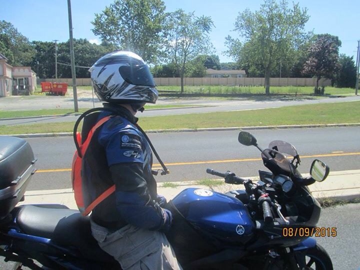

This is how I travel. Usually topcase, camel back, gps, tank bag. Only connection to the bike is the heated gloves, but those disconnect easily.
