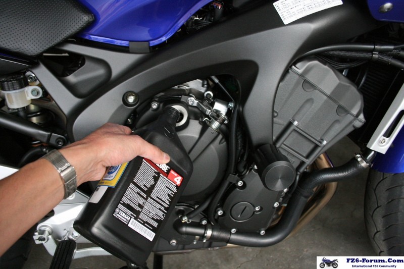

Place bike on center stand, clean area around oil filler cap and dip stick area with brake cleaner (we dont want crap falling into the openings) then remove oil filler cap and add 2 liters of Yamalube. On the 3rd liter, add in small quantities so as to not overfill, checking oil level.
