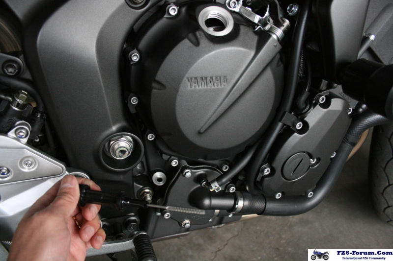

Final Check
  • Media owner bd43
Confirm that enough oil has been added by observing the dip stick. Re-install dip stick and oil filler cap. Clean area with brake cleaner to remove any oil residue. Run engine for a few minutes to cycle the new oil. Drain used oil from oil pan into now empty oil jug containers with funnel. Youre done. 30 minutes tops.
