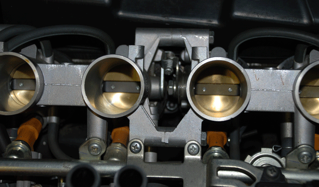

There are several threads on this topic.
To the best of my knowledge the only difference is the throttle stop restricting the maximum volume of air the engine can ingest.
Its easily corrected. However, i don't live there and don't know that they DIDN'T do other things!
If possible this could be settled by looking at the PN on the OEM ECU! If the ecu has the same part number as all the other FZ's out there, its a simple fix. Replace the throttle stop and let it breath.
Sample of US bike with NO restriction.
Position of Throttle Stop at idle:
picture.php
At WOT - blades must rotate ~ 90° from idle position!!!
picture.php
A restricted throttle stop would have that downleg below the two screws EXTENDED so as to PREVENT about 30% of the travel which open the throttle blades allowing air into the engine. Some bend it, some saw it, some replace it.
If you lift the fuel tank, the ECU is right there (Bulk of wires into one device). Read the PN from it and report back!
picture.php
[MENTION=26521]elitazzy[/MENTION]
imo - IF ECU control was there to limit the output, it would effect timing, fueling and to be real, the bikes tach would not have a need to go to 14k.
Just compare the stop and look at rotation.
picture.php
picture.php
PS - this is what you're looking for (below) vs pictures above ^^....
Notice the DIFFERENCE in where the Throttle Stop ENDS?
RESTRICTED to 33BHP...
attachment.php
I know these are different angles but its pretty easy to see the difference.
attachment.php
Restricted pic came from this thread.... fz6 s1 factory (throttle) restriction help

The Plot Thickens..... Perhaps OP can find this bike on the list and detail which one it is???
