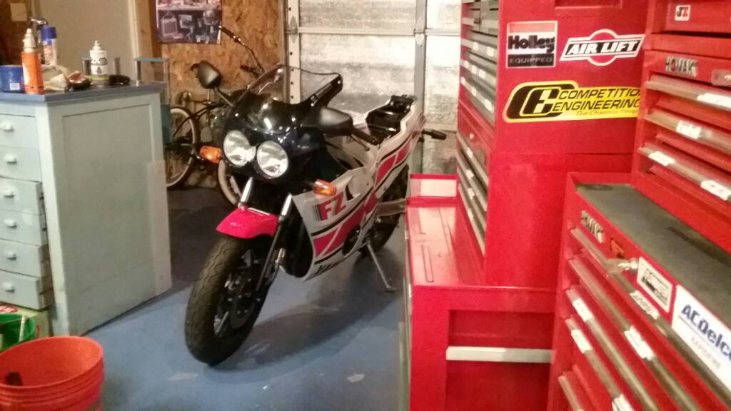

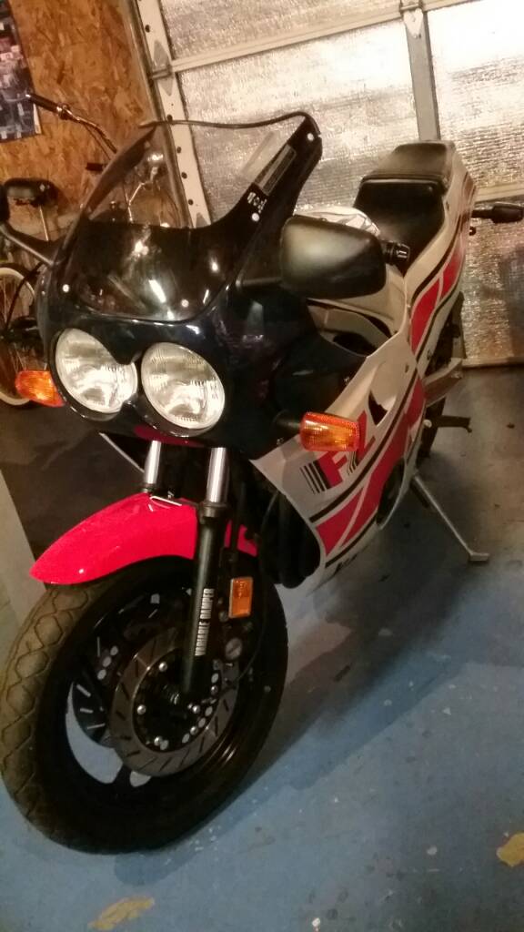

Hello. I'm new here, retired. I have an FZ600 I bought new, 1850 miles on it. It's been sitting in garage 30 years. I removed tank and emptied it back then. Recently thoroughly washed bike, changed oil, new battery, 4 carburetors were gunked up.
I got rebuild gasket kits , soaked, blew passages out, etc. They looked new. I put in non-ethanal (real) 90oct gas. It runs great!

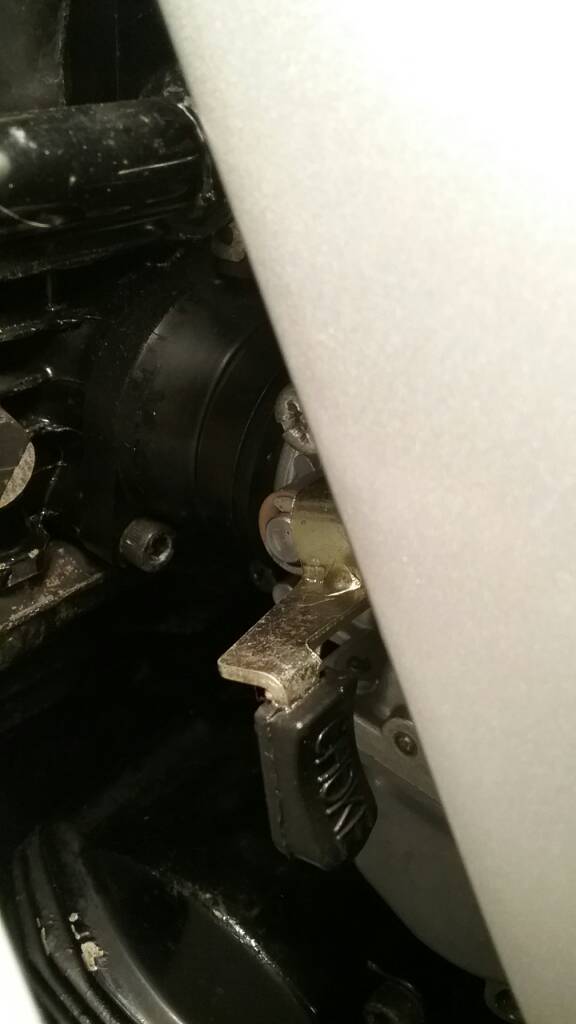

Problem is starting. I choke it, only way to start it is starting fluid I spray into air box.
Once warmed up it restarts fine.
Any assistance or ideas much appreciated.

Sounds as if your choke is not functioning / still clogged.
Click on this link, part #24 is for your choke: https://www.partzilla.com/catalog/yamaha/motorcycle/1986/fz600s/carburetor-fz600s-sc
You obviously don't have a butterfly choke and the carbs each have orifices that allow EXTRA FUEL to flow when activated.
I would start at part #24, and follow the fuel circuit, (you should be able to see the casting, which direction that orifice goes and it may very well change directions several times).
Lots of carb cleaner, pressurized air and possibly a carb jet cleaning tool may be needed.. More than likely, it's still clogged at the lower end (float bowl) area of the carb.
I'm assuming you have a lever (or some sort) to activate the choke, it's assembled correctly and you are using it...

Thanks so much. Great advice and I should have had that diagram when I had the carbs apart. I thought after all the extensive soaking, cleaning and blowing out it would be fine, apparently as you said a clogged fuel passage. I'm assuming all four are clogged. Yes, I'm choking it. It runs great once started.
