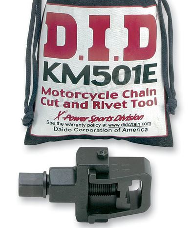

Here is a link that should have come with your chain, chain tool:
http://www.didchain.com/PDF/DID Chain Tool Inst_150.pdf
It gives specifics WHEN TO STOP with the riveter with actual numbers.
**FLARE DEMENSIONS are towards the end.
Your should be only doing this once, yes it's tedious, but GO SLOW and measure often (or you get a "do-over")
Just snug the axle adjuster lock nuts..
Make sure there's 0-ring grease in / on the new master link too.
Thanks, I had the flare dimensions ok when I did it but the pressing of the plate onto the chain link there is no set width of where to stop hence my crushed o rings, you only need to go 1 mm over to crush them. They presume you are using the d.i.d chain tool which I am not I'm using an Italian made one that does not stop, you have to stop when you think and its a complete guess. Im just going to measure the average chainlink width and go with that as long as the o rings don't look squished, otherwise its another tenner down the drain...
Yes I do have the DID tool, BUT, don't worry about the LINK WIDTH, PERIOD..
Assemble as you did before, once the rivet tool starts doing it's job the ML plate isn't going anywhere.
Squash and MEASURE the RIVET WIDTH FLARE ONLY, again, go slow, measure often.. You have the rivet width spec's now.
BTW, the DID tool I have (KM501E), I didn't know it would stop on it's own. I snuck up on the spec's and realized it was 'bottomed out" with no more to go.
Only used it twice on my current chain and previous DID chain (I mentioned earlier the x-rings failed and DID replaced it way outside warranty)

On my tool there are two steps, pressing the plate onto the link together - which you can easily overdo with my tool.
Second step is a different screw that you insert to flair with. I measured the flare widths on both studs bang on when I did it - that wasn't the issue. The issue was I had initially overdone squashing the plate onto the link and damaged the o rings by squeezing them too tight.

There is NO spec's for the chain LINK width. Please re-read the PDF, it's NOT necessary
Simply get the side plate on then tighten (back and forth to each rivet) until your at spec's.
Once the rivets are at spec, STOP... Your done... The rivet width sets how far in the ML, outside plate is.
If you simply push the plate (not riveted yet), on too far, gently pry it out with an appropriate screw driver in the ,middle of the link..(Don't damage the O-rings).
