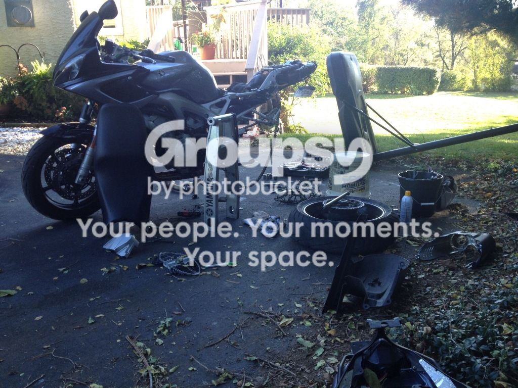

Installed the replacement chain today, took longer than expected mostly b/c of family interruptions. But what an excellent Saturday project! I learned a lot more about the bike, cleaned some areas that had probably never been cleaned before (massive amounts of greasy chain goop), and lubed up everything the service manual said to. It's probably mostly mental, but she rides soooo much smoother now.
Below is a pic after everything was apart just prior to pulling the old chain off:
Overall an awesome project, glad I did it!:rockon:
Although I did break my cheapa$$ fender eliminator in the process. Just ordered the kit from Larry on eBay. Happy riding!

jeeeeez _ impressive mess that makes :)
well done - I think that is a bit more involved than I'm ready to get any time soon (but to be fair a continuous day without rain here is....well unlikely)
