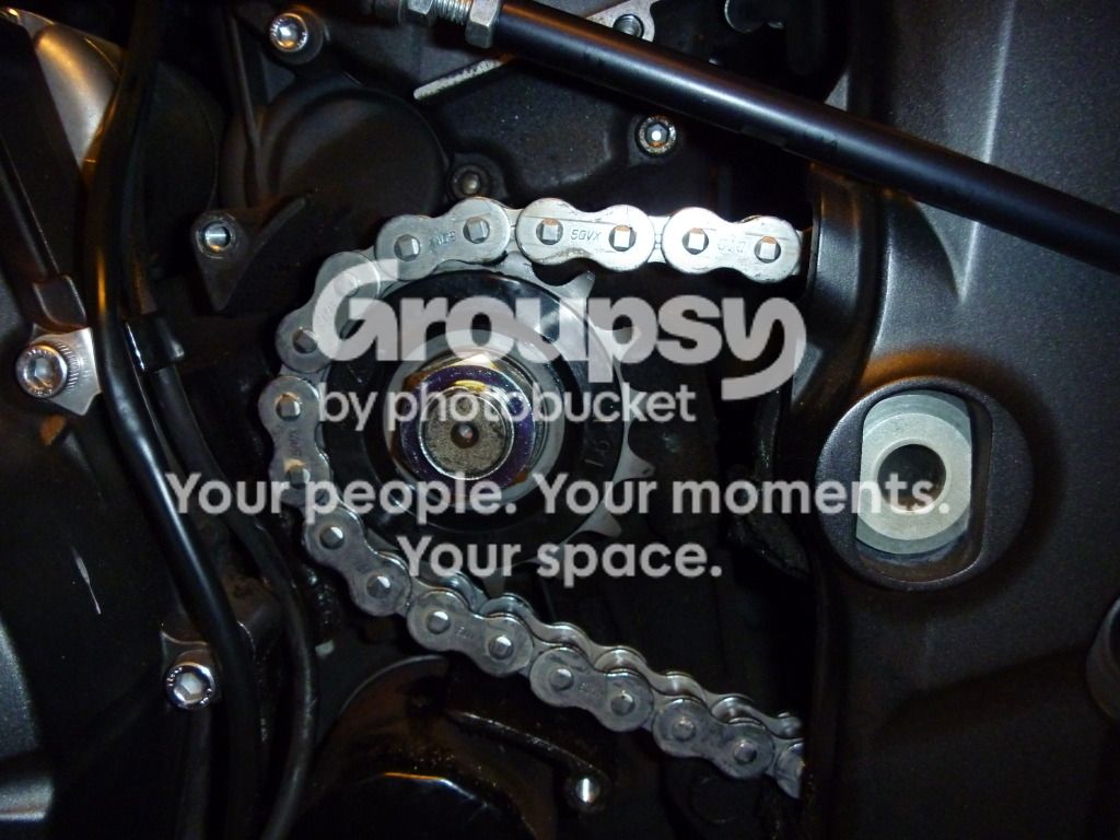

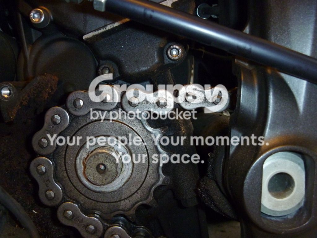

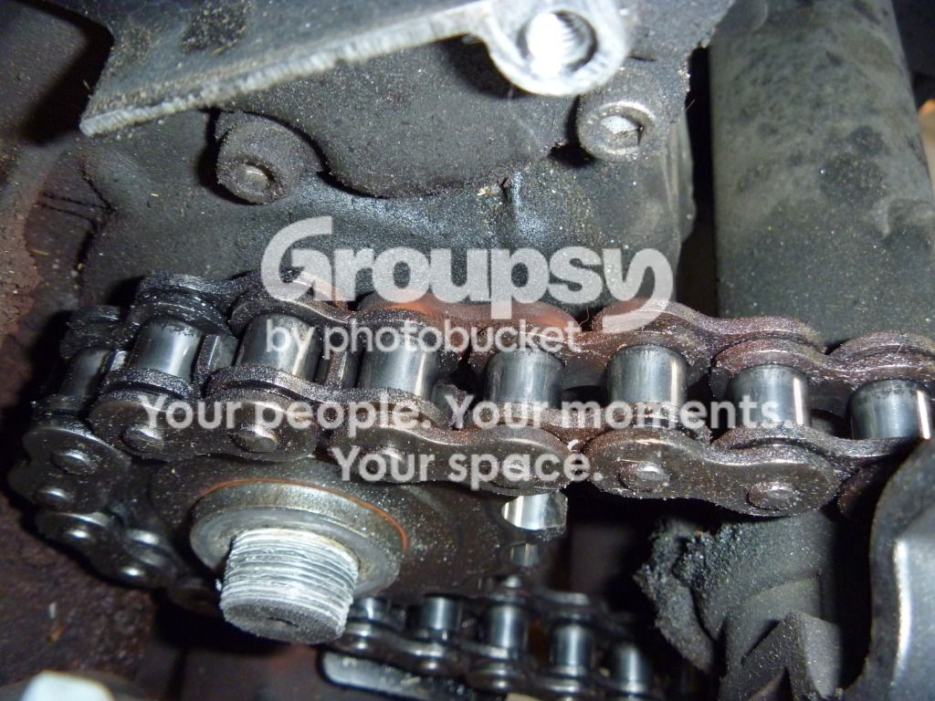

So after 37k miles, my chain was finally shot. It was really shot; it started to show signs of rust, and some of the links were binding. It seemed to go downhill fast; with regular cleaning and lubing, it showed no signs of wear for a LONG time. Then, all of a sudden, I started to notice red dust on my rearsets, and finally figured out it was rust from my chain :eek: Lubing the chain did not alleviate the problem, it was DONE. Ordered straight up stock chain and sprockets from Yamaha, since I was having trouble navigating all of the no-name parts on ebay and stuff.

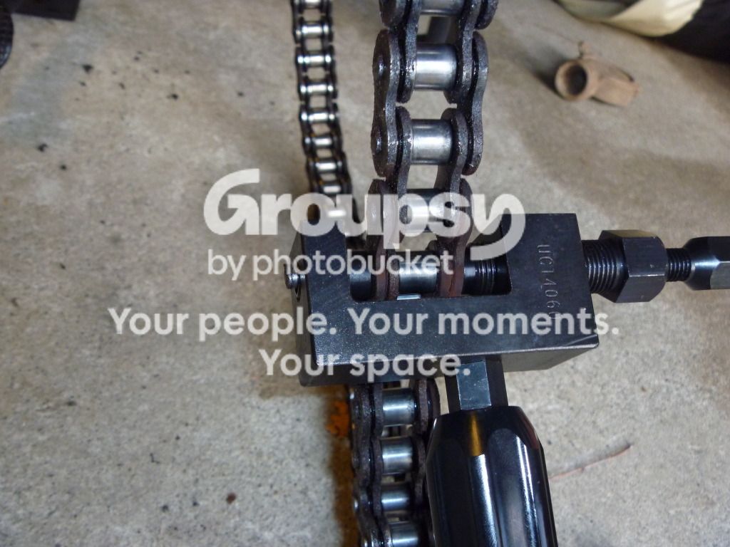

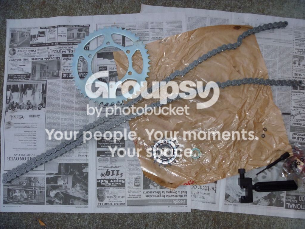

I highly recommend doing this yourself. Aside from the right sockets, all you really need are an impact gun and a chain breaker, and it's super fast to do. I borrowed both rather than buying, it only cost me a 6-pack of beer. Have no idea how much it would have cost me to have this done.
All said and done, I think it cost me $150 USD or so for parts, and about 2hrs time. I spent more time doing the dang alignment than anything else. I hate alignment.

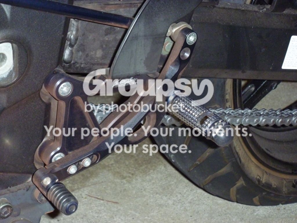

In case anyone notices, yes this pic has the new chain. I'm not trying to show the chain, but the red dust on my rearsets.

Yes I did. Stock parts, and stock gearing. I couldn't find enough information about quality of other brands compared to stock, so went with the OEM one to be sure. My first one lasted 37k miles, so I'm happy to have that exact same thing again.
I even bought them from my Yamaha dealer because the price was comparable to what I was finding online.

If you don't mind me asking what are those rear sets :) and did you replace the but and washer on the front sprocket ?

Valtermoto. They're pricey, but sweeeeet! Very grippy.

It didn't come continuous, and in my searches I didn't see any that were continuous. All the ones I found had master links with them. There are two kinds of master links: clip-on and rivet. Since I had a chain breaker tool, I got the rivet kind because I felt it would be more secure.
Another reason to do it with a chain breaker is that the OEM chain actually comes with an extra couple of links that have to be removed (mine did anyway). You either have to do this yourself, or have a shop do it for you.

Yes, it's pressed on. The chain breaker tool has all of the inserts needed for breaking the old chain to get it off the bike, and riveting on the new master link.
The master link comes with the link (side plate and two pins), o-rings, and the other side plate. When you get the chain on the bike, you put the master link and o-rings in place, and then press on the side plate. It's a pretty tight fit, so everything stays together. It's designed such that you can't over-squeeze the parts together, it stops at the right spacing between the two sides of the link. Then, you use another insert on the tool to flare the rivets and lock it into place.
I was a little sketched out about the idea too, but once you flare those rivets on the backside, you'll see how secure it is.
