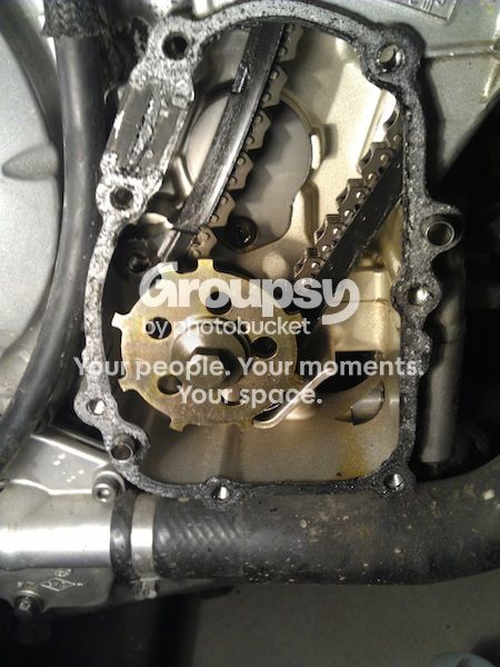

Andz, are you talking about the Torx head bolt on the outside of the case? Its for checking the timing! You remove the plastic plug in the middle and shoot a strobe style timing light into the hole and with that Torx bolt removed, it frames a Window "slot" so to speak to align the Trigger Wheel timing marks too.
Take a look here. Right next to the pickup coil is the end of the torx bolt. When the cover is in place, the Torx head bolt and the center cap are removed to check the ignition advance. The Torx bolt need not come out to remove the cover.
Flip the cover around into place and the bolts slot aligns ~ with the arrow on the case.
attachment.php
The whole cover:
attachment.php
A close up of Trigger, the guides, and Chain.
attachment.php
