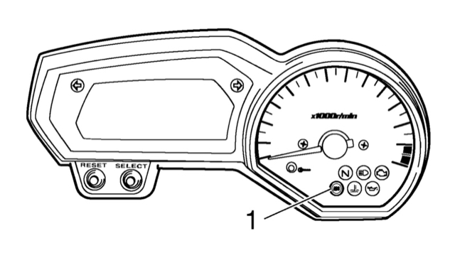

Here's the ABS light (the 1 show the location):
The light should light up for 2 seconds when you turn the ignition on. It should be permanently on in case of an ABS failure.

Sorry for the delay everybody. I had to get back from holidays to actually inspect the bike.
The weird thing is that no, it doesn't have the ABS light on the dash.
