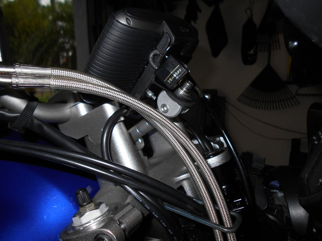

I’m just thinking about my installation of the SS lines a few years back…I believe that the “race kit” and the regular kit are one in the same, the only difference is where you decide to use the double banjo bolt (master or right caliber). I did dry fit both styles but I found the double lines to be a little cleaner. At the time I thought the double lines would be easier to bleed (fill from the bottom).
You need a shorter line to JUST go over the fender.
As I re-call, bleeding the double lines was slightly easier.
I just didn't like the extra line cluttering up things.
The double lines, before I went back to the single line:
