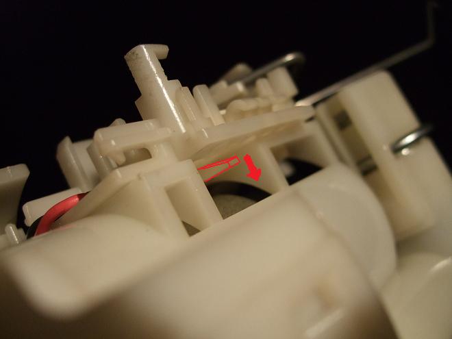

Here's some pic's on the pump apart. You can get to the filter but be very gentle with it..
Hi there.
You replied to me yesterday on my similar issue of FZ6 losing power and galloping at higher revs.
I just wonder, do you still have those photos of how to remove the gauze filter on the fuel pump to clean it.
I'm planning on tank off this weekend.
Thanks,
Simon
