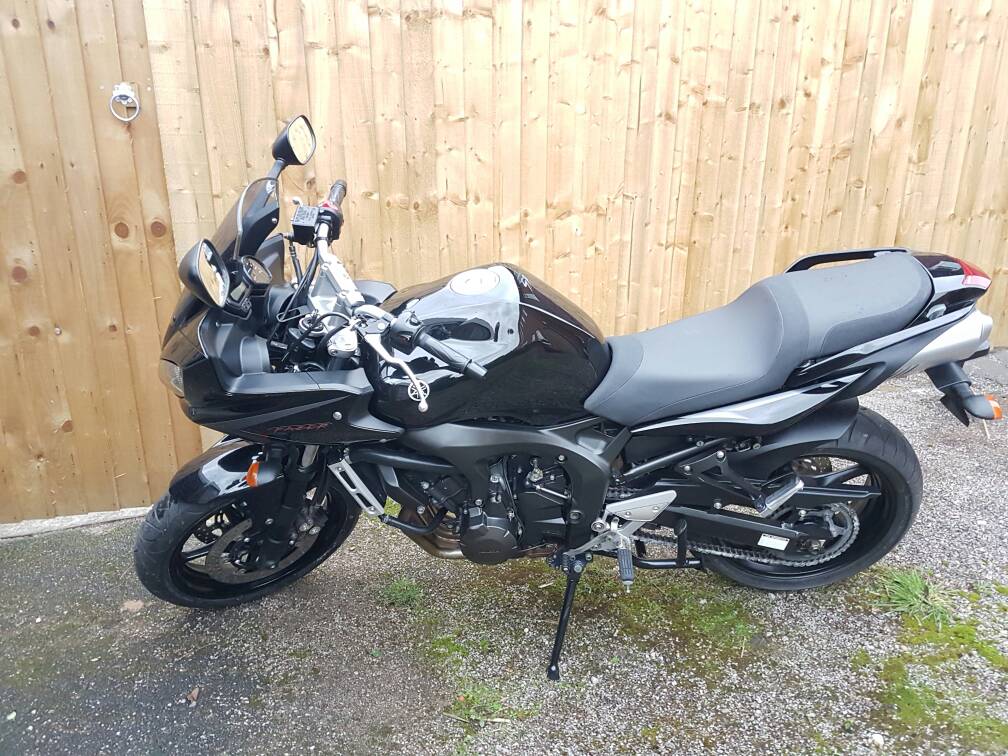

I've recently passed my bike test and purchased a 2007 fz6 s2 with 11k miles on the clock in black. I absolutely love the bike and I'm very happy with my choice, I'm just taking it steady to start off with. It's a lot faster than the bike I learnt on!
Here's a pic of the bike:
