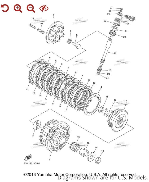

Note that there are six each number 5 style and two each number 12 style friction plates and seven number 6 and one type 4 steel plates. Note their location…they have different thickness.
Yeah the 2 dark brown friction place go to the outsides and the bigger steel goes in the basket 1st
