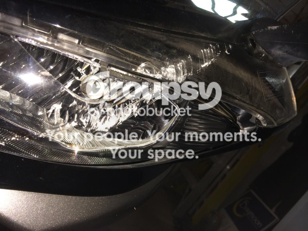

Popped the left turn indicator out, smashed a headlight and the windshield.
Question one - are the headlight assemblies the same through 07...they seem to be.

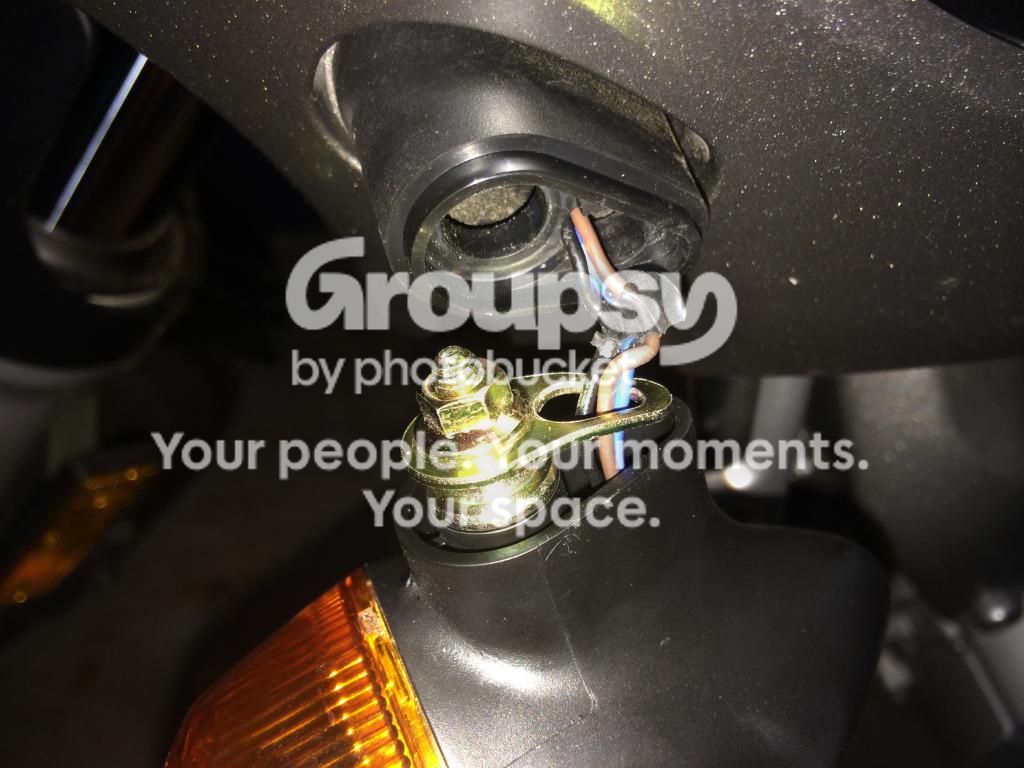

Question two, does that turn indicator pop back into the rubber stalk? I am having problems.

Yes, 07 - 09 are all the same for the headlight. Some take this option to get undressed. It depends on your needs. The Nakid parts conversion may cost as much as a used fairing tho...

For fairings, the chart says that the 04 thru 06 are compatible, then they changed for 07 thru 09. BUT I've also heard that the change from S1 to S2 happened during the 2007 model year, so your 07 might be the earlier version. If the fairing has a sort of cut-out on both sides then it and the headlights will be the same as the 04 thru 06. If the sides of the fairing are solid (see the pic of my 08 on my profile) then you'll need the S2 version.
On question 2, yes, the turn signals are designed to survive some versions of a spill, but things can go wrong. Look closely at the one on the other side. The stalk changes from a hard plastic to a rubber part that fits into an oval opening in the mounting on the bike. Then from the inside of the mounting, there's a flat plastic (black) oval shaped disk with prongs at top & bottom that fit into the rubber stalk that extends through the mounting. The wire goes through a hole in the center of the disk - so if it's not right at the mounting, it should be nearby on the wire, unless it split and dropped off. If it's gone it should be cheap and easy to get one at the dealer.

I see some 07 headlight assemblies. Will they work?

Heck...the dealer was almost as cheap as ebay for the headlight assembly.

Any tips on getting the turn indicator back in?

As to your turn signal. The bolt and little metal tab are suppose to be in the inside of the rubber collar. See the pic of my signal apart (ignore the extra cut wires, you will only have the gray connector if it is stock). The way I see it there, must be a cut or crack somewhere for the metal piece and wire to come out like that so inspect carefully. The others mentioned the black collar, which is on the stalk inside the fairing.
Edit: it is actually a nut and not a bolt that holds the metal tab on.
Sent from my DROID3 using Tapatalk 2
I agree it looks like it pulled through, but the bolt and wires are in distinct holes. For both to pull through there must be a crack connecting the two. It may go back together and be just fine, but the metal piece definately belongs on the other side of the rib inside the flexable rubber. The metal tab is also originally flat, not bent.
