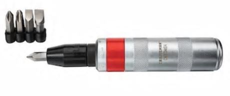

If we are now in 'tool talk', then you want to look at the Vessel JIS screwdrivers. Aside from having the correct tip for 'Japanese Phillips Heads', the are also impact drivers that rotate when struck. I have 2 of them and they work great.

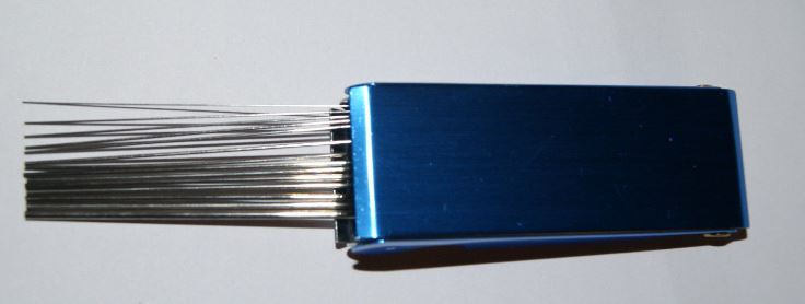

Off topic a sec but what is this(I use VERY often- NOT on the FZ), what is it??
(NO prize for the correct answer either..):

Thank you for all the insight!! This tool is for cleaning carbs i believe! Also I have seen the stubby impact screw driver used on automotive brakes! I believe we have those at work! I was only going to use a vice grip because I was following this post on removing fuel injectors on an R6. Impact screw driver makes much more sense! http://www.proflowtech.com/2012/05/removing-yamaha-r6-injectors/
Bing, bing, bing, we have a winner!
Yes, it's a carb jet cleaner. Various sizes for different sized jets.
