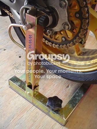

I'm thinking of making my own trailer restraint instead of buying one
QwickFliCk
Manly Man Member
Feb 20, 2011
815
23
NY
like pitbull's strapless trailer restraints, ive looked into the ststands trailer restraint at ststands.com they make one for the fz6 for $250 but im pretty sure that i could make that w steel square tubing, metal rods, sawzall, a drill, and a welder for less than a $75.
anyone have any ideas on the axle rod holder???
the only downside is that do i trust myself enough that my DIY trailer restraint will hold my bike upright at 60-75mph on a trailer not strapped down lol:confused:

Just got my Pitbull (thank you, riderCoach discount! :D .. 15% off is better than nothing!)
Cool idea, Ant. I would think any pipe with external diameter closely matching the internal diameter of the axle should be the staring point. Then maybe safety pins on either side to keep it form coming out?

I may get one of these for the 2nd bike.
12,536
1,182
Your front tire better be pretty sung in the front stop.
If there's any play between the width of the front wheel and the front wheel holder, the front steering can (and will) turn and thus loosen up that rear hold down, (especially of you hit a big bump at speed).
IMHO, I don't put a bike on a trailer without at least FOUR STRAPS, two for each side. Should one break, you have another as back up.
It could be as simple as a canyon Dancer set on the loose side to a soft tie wrap around the rear of the frame of the bike, tied down forward to the trailer.

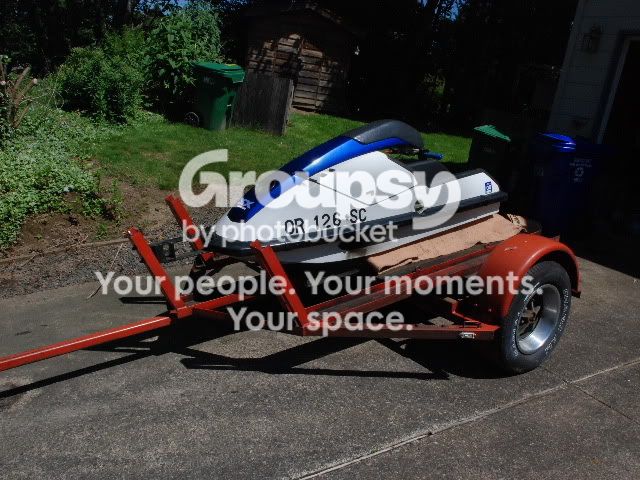

In 88 I designed and built this 3 bike drop axle trailer. Later when ski's came in to the picture, fitted runners for ski's. Combo's 1 - 3 bikes or 1 - 2 stand up skis.
Its been up and down the west coast a couple dozen times with no failures. That includes some cripples being hauled back from desert races in Nevada. :thumbup:
Trailer is looking a bit rough after 20 years outside! :(
Even the marine grade decking had rotted and the outer runners for the skis had to be removed.
Notice the long neck. Very stable at ah - higher freeway speeds! :spank: Plus conventional wheel size to match cage so speed rated tires are plentiful!
